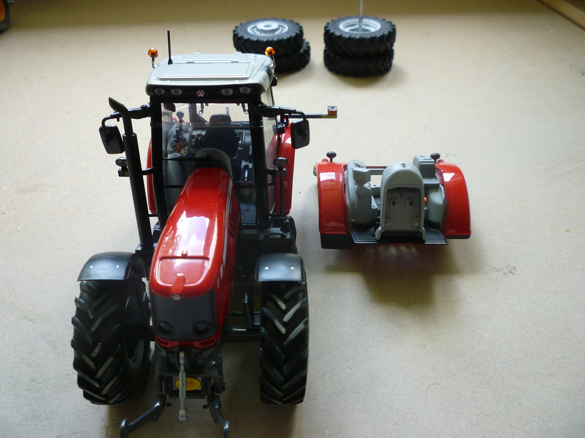

bluegreen Posted May 20, 2012 Author Posted May 20, 2012 First job was too remove wheels, cab and mudguard platform and to achieve this the bonnet has to come off as well. The best way to remov it is hit it with a punch and hammer halfway along the underside of the bonnet. This way you wont damage it badly like I did to the 7499 by trying to lift the bonnet off above the front linkage As the pic shows there are two mounting points for the bonnet so halfway between is the logical removal point. Once the platforms are both off you soon notice that neither cab or platform are identical not even close which wasnt unexpected with UH So out came my mini angle grinder for the first of many visits! Quote

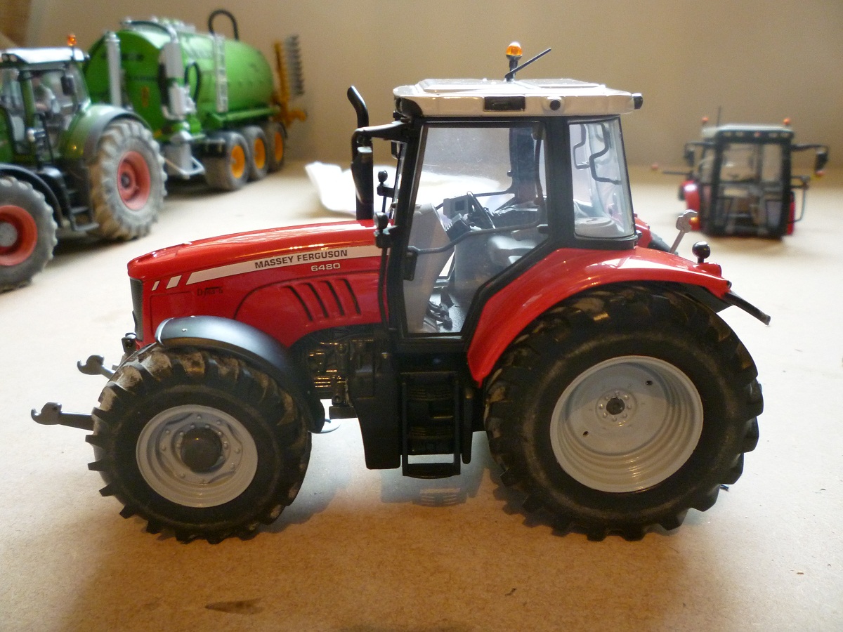

bluegreen Posted May 22, 2012 Author Posted May 22, 2012 ALL DONE A few final tweaks tonight with the right side steps glued into place and the cab as well. In my view the realsize MF6480 tier3 version is and will be regarded as a modern classic and its also a great looking tractor, so im really pleased this expensive convo has turned out well Hope you like it . Hopefully I will be able to take some better outdoor pictures of it in a suitable backdrop over the weekend. Quote

bluegreen Posted May 23, 2012 Author Posted May 23, 2012 As a Massey man that looks spot on well done really like that that's how they all should look like I have to agree Bob as basically all ive done is marry the parts that were correct from 2 MF UH tractors (6480 US, 7499) plus wheels & tyres from others to make a 6480 that UH should have made in the first place! Quote
